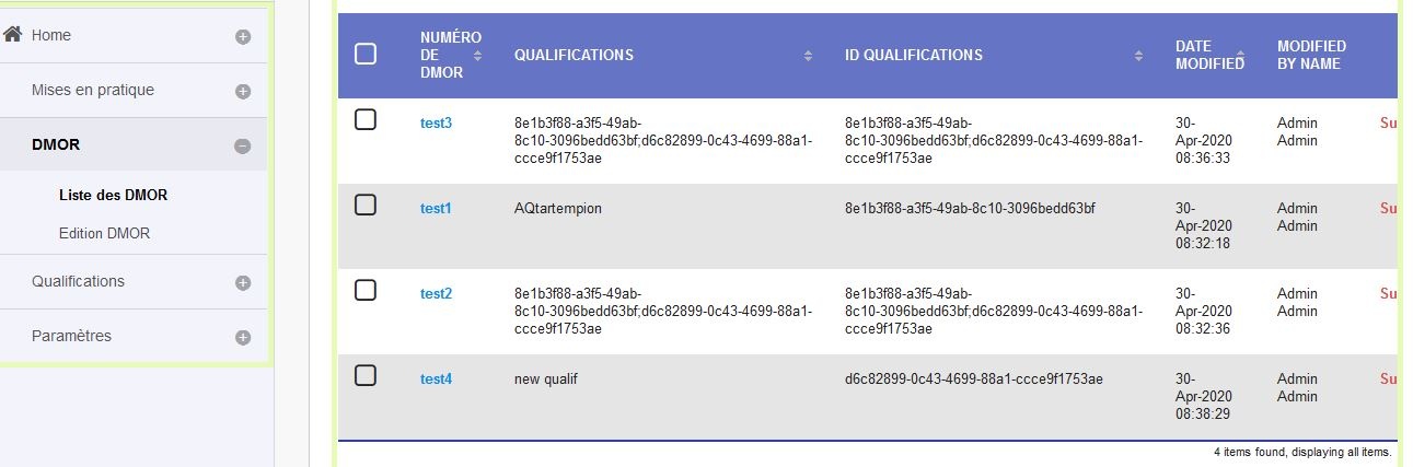

Hi all,
I have been using formater binding possibilities to show in data list a foreign key for a while, and this operates perfectly.
I am now encountering problems when a source field is a multi select field, when mulitple selects have been done. In this only case, the formatter doesn't show in datalist the foreign key but the source key.
Thanks for your comments.

    Are you using "options" formatting? the data source of the table is basic or advanced form?
  2. Vincent Bazinet
    No I am not, since I am just using community edition. I am using default formatter.
    The datasource is the default joget datasource.
    I enclosed a screenprint of the problem: One can see that field "id qualifications" is represented by another field (its name) in the middle column, when there is only one value in "id qualifications". Whereas, when there are two values (multiselect choice), they don't transform.

      Hi, did you try to use the Options Value Formatter? It should work for single or multiple values.
