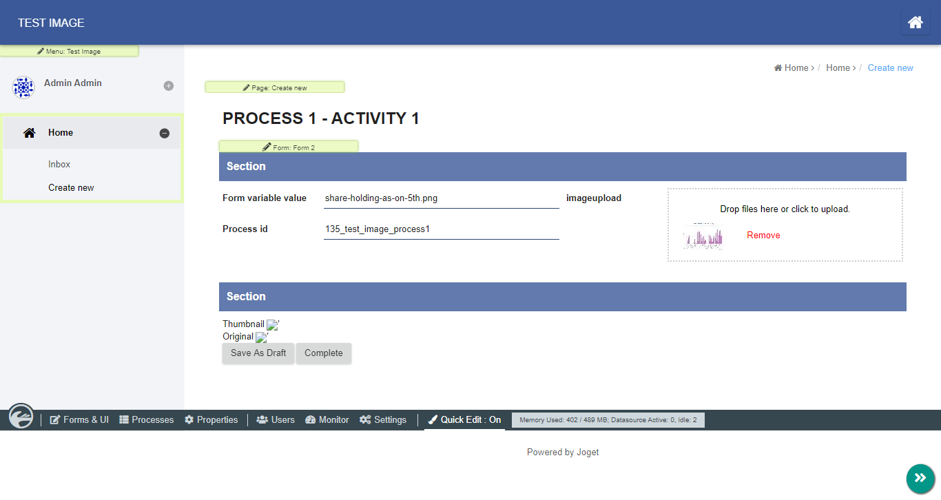

Hi. In the flow variable it will only save the name of the file. However for assembly of the reference in the IMG tag, the URL of the processed file and the form ID must be included. This is an SQL statement that assembles the tag, but it's the same idea:
<img src="/jw/web/client/app/lider_gestion/11/form/download/bd_bordado/' || id || '/' || c_vista_previa || '.thumb.jpg." height="40%" width="40%" align="middle">'
Be careful of the point that is added after the file extension! I think its inclusion is always necessary.

Hi all,
I am trying to pass an image from form 1 to the second custom HTML img element with hash variable. I am getting the image name but the image is not being displayed I am not sure if this is being done properly. Would Like to get some guidance in this direction
