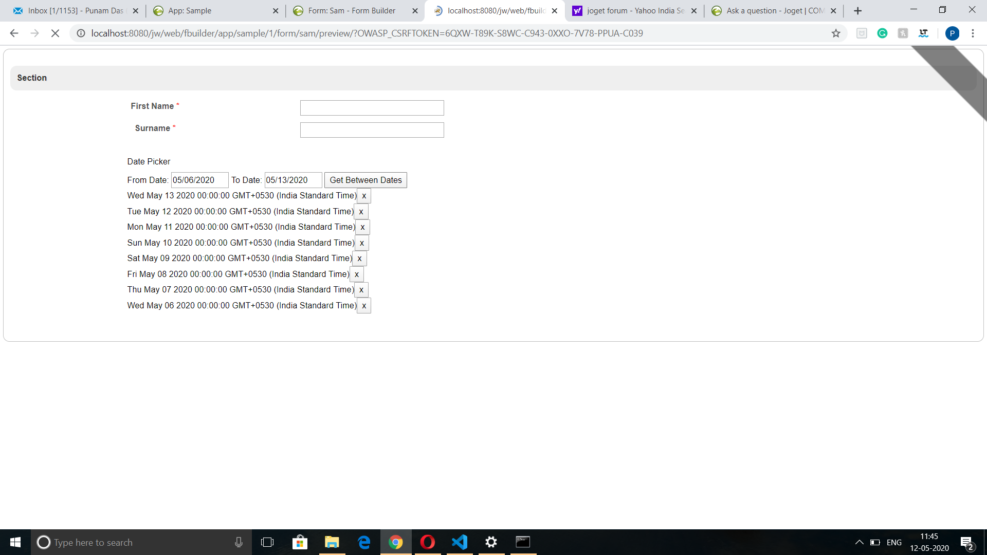

Hey everyone,

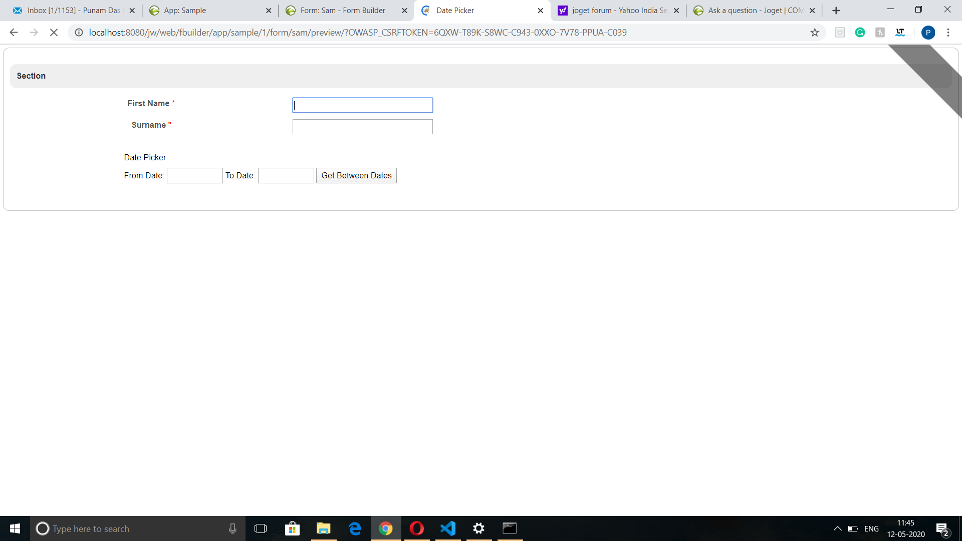

I have created a custom calendar that will display dates on the click of the custom button! The code is running properly outside joget . But in joget ones I click on the button, it reloads the page can u shape me out with the issue?
This is what it displays and very soon it reloads the page and come back to the previous one.
I am also sharing the code so that it can help u to understand. Hope I have convened you all my query properly
$('#getBetween').click(function () { var start = $("#date_picker1").datepicker("getDate"), end = $("#date_picker2").datepicker("getDate"), currentDate = new Date(start), between = [] ; while (currentDate <= end) { between.push(new Date(currentDate)); currentDate.setDate(currentDate.getDate() + 1); } $(document).ready(function () { $("#results").html(between.map(function (value) { return $('#results:last').after('<div class="block">' + value + '<button class="remove">x</button></div>') })); $('.remove').click(function () { $(this).parent().remove(); console.log(between) }) }); });
