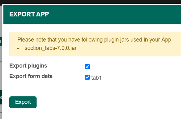

      On a related unrelated note  when exporting the App it only shows Table that have to be selected one by one and not a single click App. I checked the documentation and it should show the single click app that can be exported that would have all the tables. Screen shot is attched,ExportApp.png
