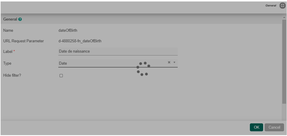

Hello I am creating a plugin to personalize the search filter of a datalist I deployed my plugin in joget server but when I choose it to configure the input the screen freezes without having errors
if you choose this plugin the screen stays like this :
