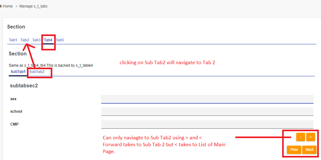

In my example, I wanted to create the user interface such that under Tab no 4 there are two more Sub Tabs (ti.e SubTab4A and SubTab4B). When I try to create the application there are two issues I notice
  1. The sub-Tabs Shows two navigation Bars Next / Prev.
  2. When I click on Tab 4B the application for some reason goes back to Main Tab2.

      Multipaged Form does not work well within another Multipaged Form.
      You are right. It seems to be navigating the parent's tab when clicking in second level tab.
