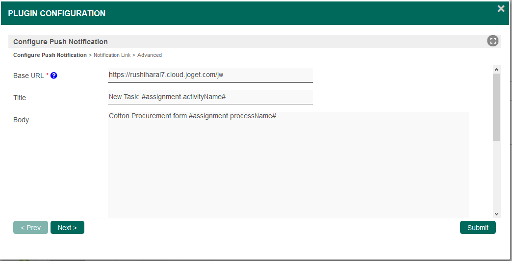

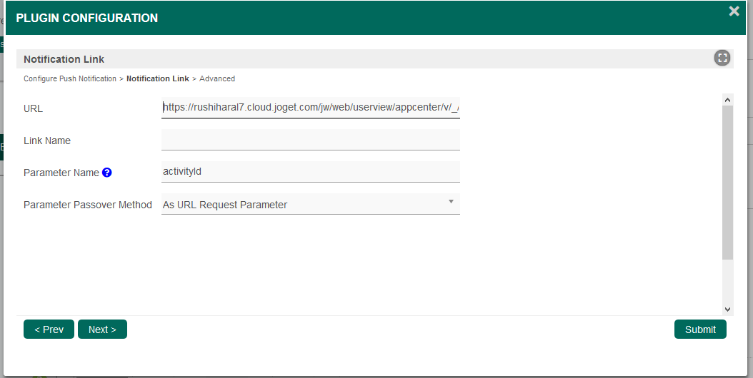

 I am trying to integrate mobile push notification audit trail plugin in my app , but it is not working. I did according to the guidance : These are the screenshots:
url in the above pic is :  https://rushiharal7.cloud.joget.com/jw/web/userview/appcenter/v/_/_ja_inbox?_mode=assignment&
What am I missing here?
Please reply ASAP.

      2. Walter
        Have any of the users "ho, manisha, rushikesh, virat", used their mobile phone Chrome browser and surf to your joget site and accepted "allow notification" before?
        There should be follow up message after
        INFO 02 Aug 2020 16:46:59 org.joget.apps.app.lib.UserNotificationAuditTrail - jwc_rushiharal7 : Users to notify: [ho]
        that says send email completed, or notification sent.
        It is likely that these users have no emails configured, or didn't subscribe/allow push notification from their phone browser or added the joget site as PWA yet.
