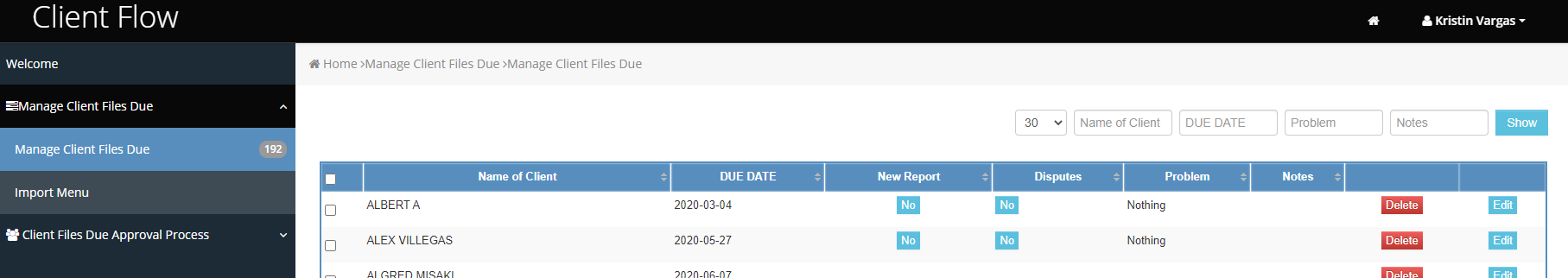

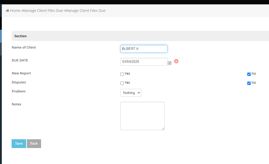

I have a form and on that form, I enter my data for my datalist
On my datalist, my entries show with the data that was entered on the form
Instead of an editable dropdown as I want it to be, it only shows the actual value entered from the form. I then have to click on "edit" or "open" to change the value of the option.
I would like to be able to change the value of this dropdown for these records

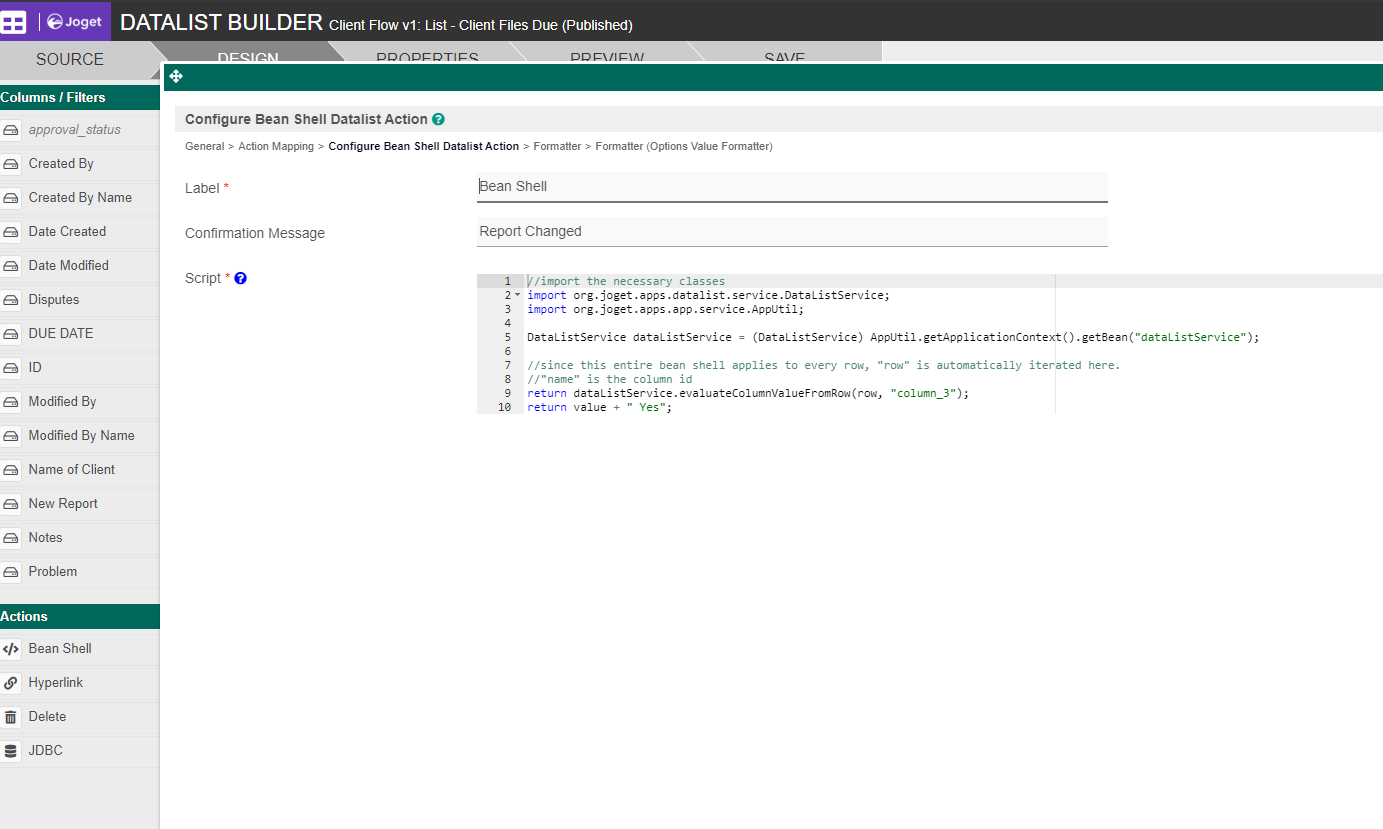

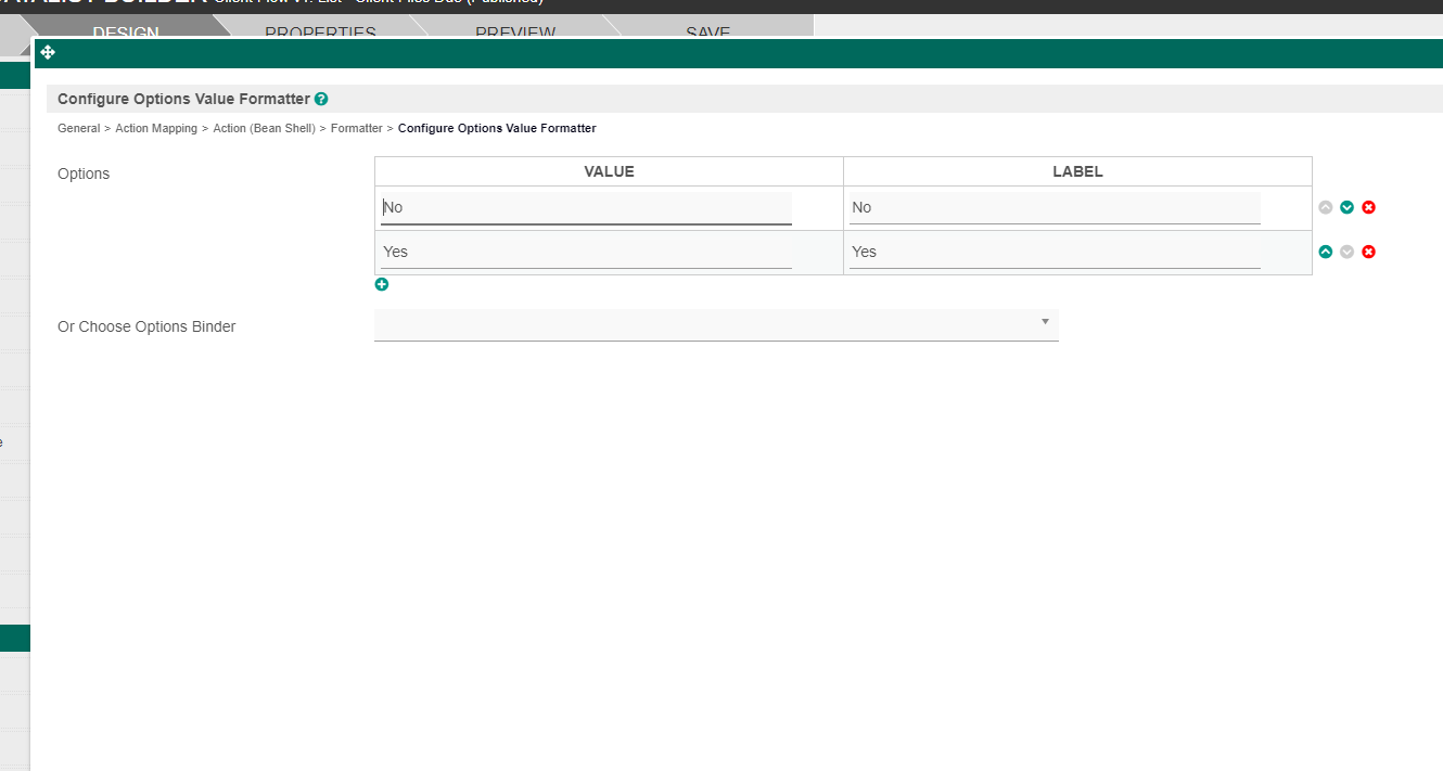

After spending 6 hours on this instead of the 12 hours of work that I have to do, i was able to get a default value of "no" to show and it can be clicked on but I am unable to get it to change to 'yes' as i have in the script or anything else.

I have a datalist with containing records with text, date, text area, 1 dropdown and 2 checkbox options.
i find it very inconvenient to have to click to edit the record in another screen and would like to be able to edit the values (the checkboxes and dropdowns are what I would really like to be able to edit) WITHOUT clicking on edit to open a screen.
I found the datalist beanshell formatter and the script looks like it would work for this but when I enter it in on the datalist → formatter → beanshell screen nothing changes.
