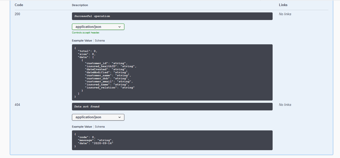

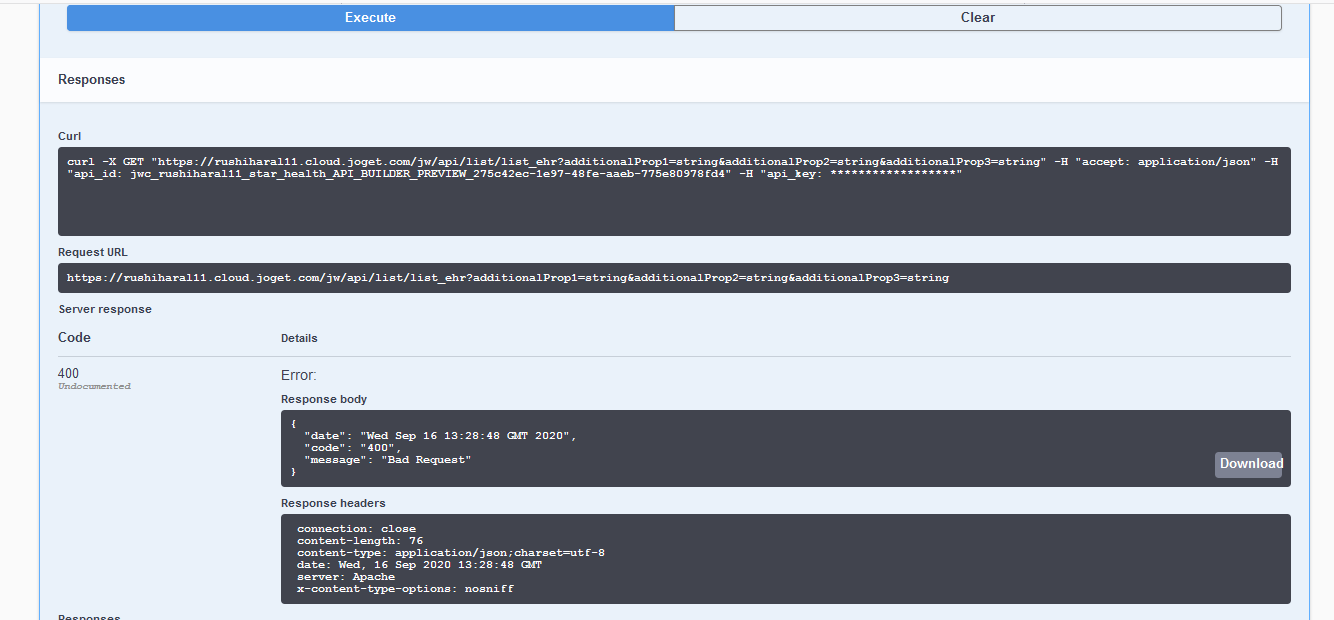

I am using API builder to create API of my joget datalist. I have followed the documentation and got a response url.
But when i am hitting that url in browser it shows Joget system error. If this details is not sufficient i am attaching SS also.
I am new to API thing so if i am missing something please help me.
      I have followed documentation ... there was nothing like that. Can you please guide me?
      1. Anders

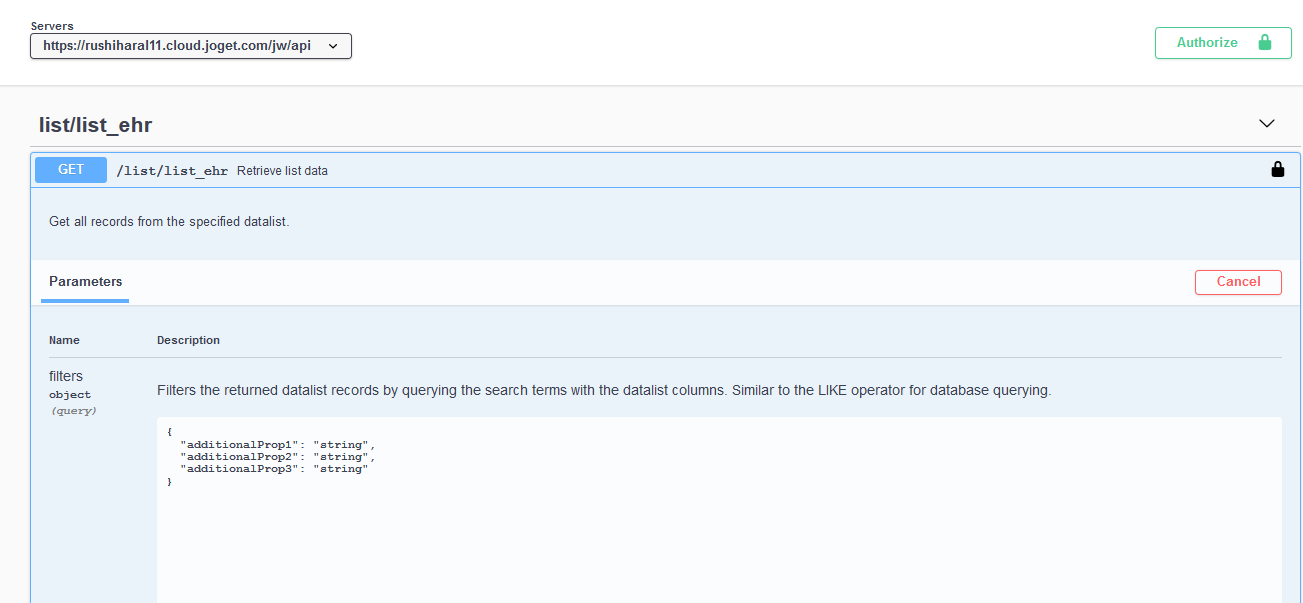

        It is mentioned in the List API, under Query String Parameters
    2.
      Hi, from the screenshots you seem to be using the List API? Did you set appropriate values for the startOffset and pageSize parameters?
