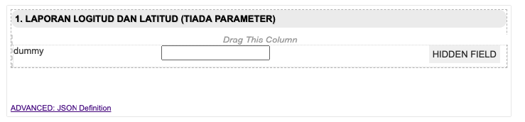

i tried to make form readonly, but imposible because that selected value from form need to be used as parameters in jasper report. dynamic parameter was build using jdbc query result bind to select2 (multi select) form.
hi, im using form as redirection only, to get value in form and submit it via redirection get parameters. how do i prevent it saving any data into table defined in form ?
hi, im trying this trick. make sure this form use store binder → Bean Shell Store Binder .. then put on beanshell :
import java.util.*; // cant leave blank file. just some java stuff.
sighhhh... working on legacy v5.
