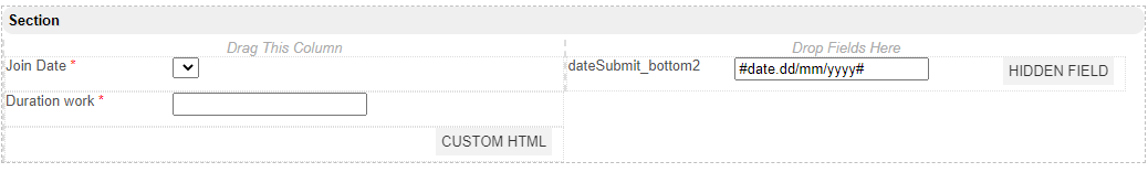

      3. nfmr
        So I use custom html and code like this but still nothing happen. Can you please help me to check which part is wrong? I've been working on these for a few days and keep changing my code also cannot.
        The date format is dd/mm/yyyy.
        $( function(){
            $('input[name="PIC_joinDate_bottom1"], input[name="dateSubmit_bottom1"]').change( function(){
            var start = new Date($('#PIC_joinDate_bottom1').val());
            var end = new Date($('#dateSubmit_bottom1').val());
            var Difference_In_Time = end.getTime() - start.getTime();
            var Difference_In_Days = Difference_In_Time / (1000 * 3600 * 24);
            $('input[name=PIC_duration_bottom1]').val(Difference_In_Days);
