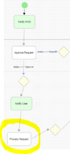

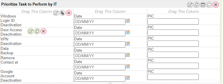

I would like to loop the following process 3x as it require to be fill in by 3 respective individual for the following request as per example below.
I would prefer if the loop method is possible rather than creating the process 3x.
