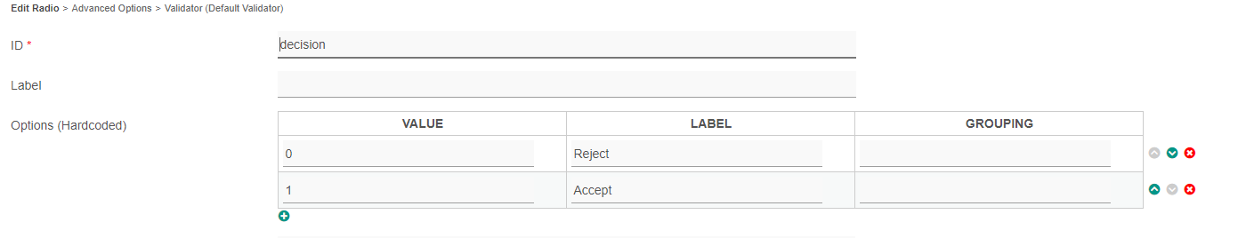

I have a radio button on a form. In the email tool I want to show the option selected by the user in the message body. It is coming up as empty. It works fine when I user a select box. Here is my radio button options

        #form.request.decision# should prints 0 or 1
        #binder.options.request.decision# should prints Reject or Accept
