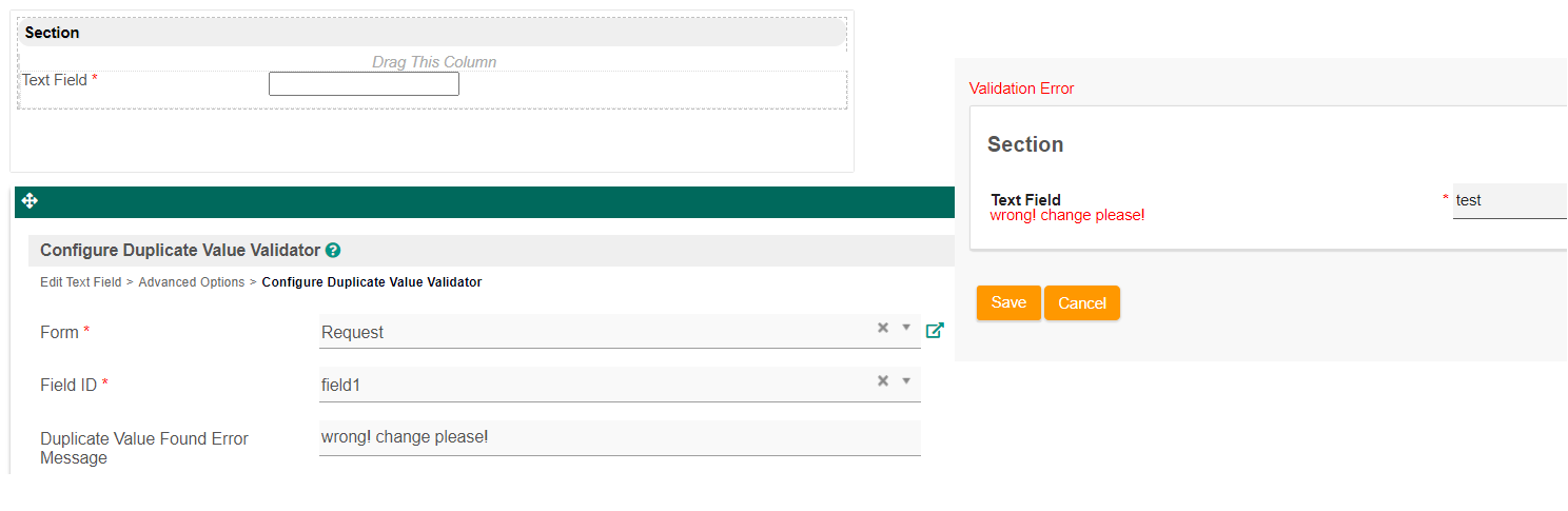

        Hi, yes currently I use that. But I want the error message to be something else not "Value already exists"
      2. Ian
        there's a field called "Duplicate Value Found Error Message" under the "Duplicate Value Validator" properties to customize the error message

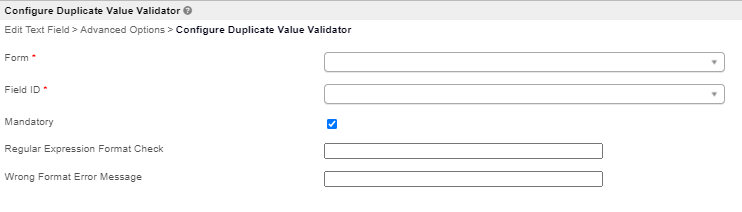

      3. nfmr
        i do found this field "Wrong Format Error Message" under "Duplicate Value Validator" but the error message still shows "Value already exists" not as what I write hmm not sure why
      4. Ian
        curious...what version are you using? I'm using enterprise 7.0.12 and it works for me.
      5. nfmr
        mine is enterprise v6...
