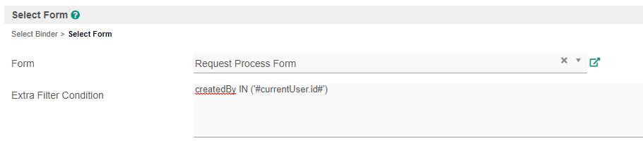

If not mistaken the variable, '"#currentUser.department.id#" is not applicable for community version of joget, correct ?
If that is the case, then I am unable to perform as per your suggestion.
Currently I have set up a datalist to allow the requestor to view their own request using the below filter
I would like to know how to allow the HOD to view their own respective section request only.
Example, HR can only view HR member request, while Finance can only view their own.
