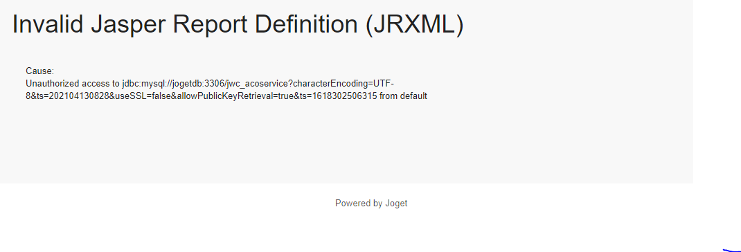

Hey, I am not using a custom or external datasource, I have configured my jasper for default datasource, it works fine if there is just 1 dataset in my jasper report. but when i use a table to get the relevant information to the parent dataset, I create a child datasource and set its configuration to "use same jdbc connection as master report "it gives me this error shown above. and The master report is configured for Default datasource

I am not familiar with how JasperReports handles child datasources, but it would seem it is attempting to make a separate connection. To overcome these security restrictions you might need to either use the Dedicated plan or deploy an on-premise installation.

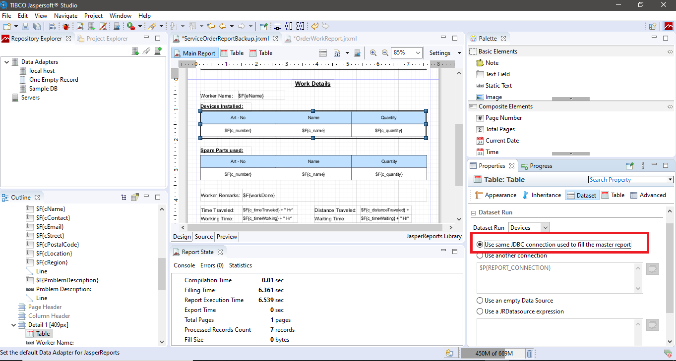

So, I started debugging, i built the report step by step and checked it... This is what i have noticed. If I select this option fig-> "Red box", in the table dataset. I get the error shown above. if i change it to empty dataset then it works fine. Any one with the fix??, or is it a bug that nested datasets are inaccessible in joget cloud?

Hey I checked the app, couldn't find the problem. When i import my app and run it on local server, jasper works just fine but it isn't working on the cloud. Maybe I'm doing some db connection wrong?

In your app, try to configure the JasperReports to use the Default Datasource instead of a custom DB connection.
