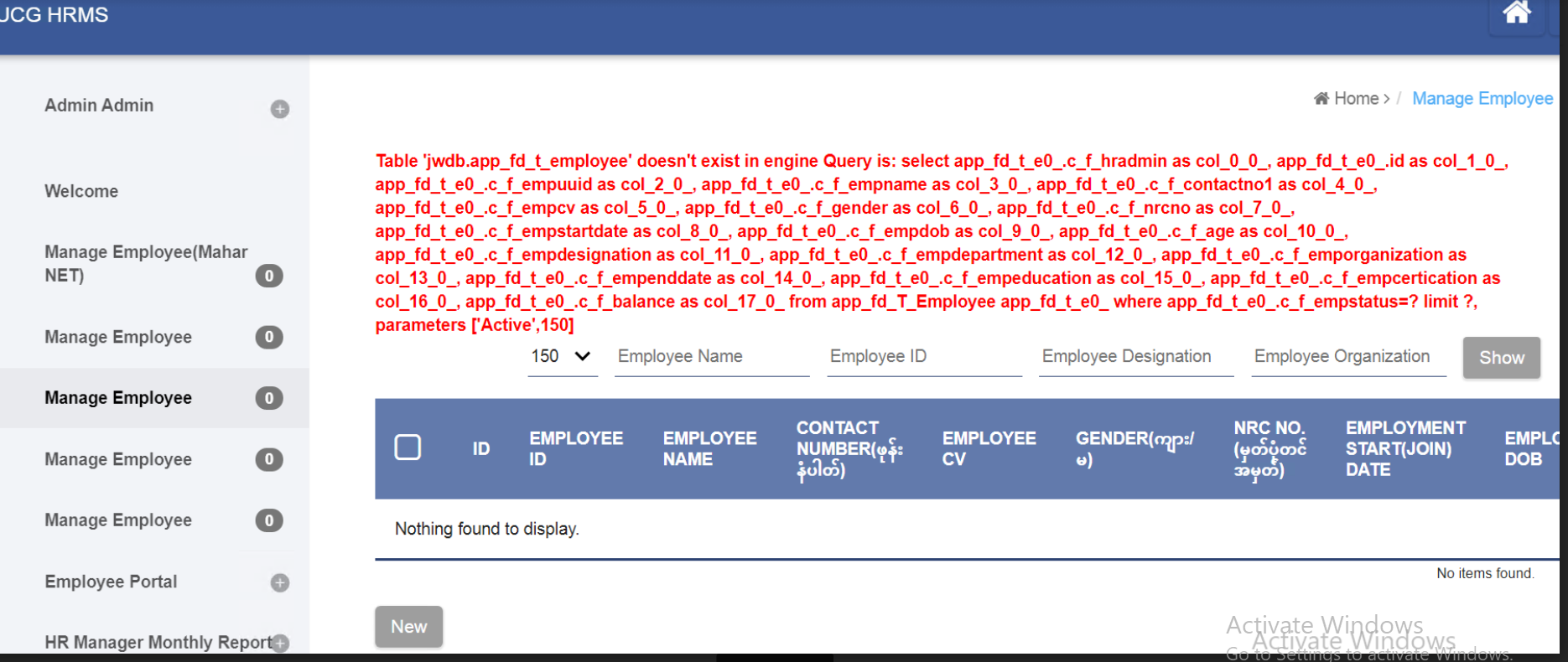

I have managed to restore joget by replacing faulty folder. Now apps are up and running. But no data inside ,just showing like this. Could you please help how to restore data back? Old data folders still remains.
Error message" Table"xxxx" doesn't exist in engine Query is.......

      Hi, from the error message it appears like the database is corrupted which means that it was not restored properly. What database are you using? Assuming you are using MySQL or MariaDB, then the proper way is to use the mysqldump utility https://www.sqlshack.com/how-to-backup-and-restore-mysql-databases-using-the-mysqldump-command/.
