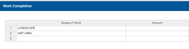

Division List, Once division select need to sub-division display into the spreadsheet column
Spreadsheet: Under Scope of work column now showing 2 that is default value set but I want to select division based on that display the data .
Query: Query I am trying to use on Spreadsheet JDBC Binder
SELECT c_sub_division as scopeofwork FROM app_fd_subdivision_profile where c_division='#form.ipadetails.division#';
ipadetails: Current form table
- Matthew King
As mentioned earlier, to use the #form....# hash, this value needs to be in the database, not currently edited form where you change the field value.
Do try using instead the AJAX Subform where the spreadsheet sits in the subform and you link the subform to the selectbox field. And in your subform load binder, use this hash '#requestParam.primaryKey#' variable in your SQL WHERE clause. Using the Ajax Subform, you can then populate the subform containing the spreadsheet dynamically and in real time. There is a demo app in this KB page you can download to learn how.
