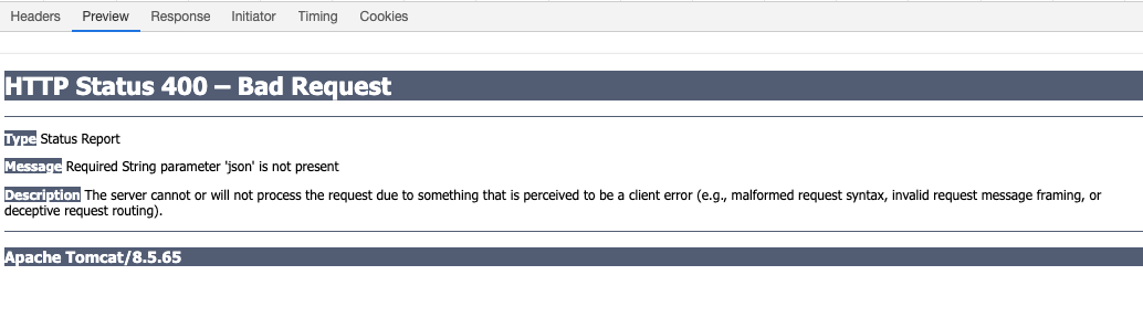

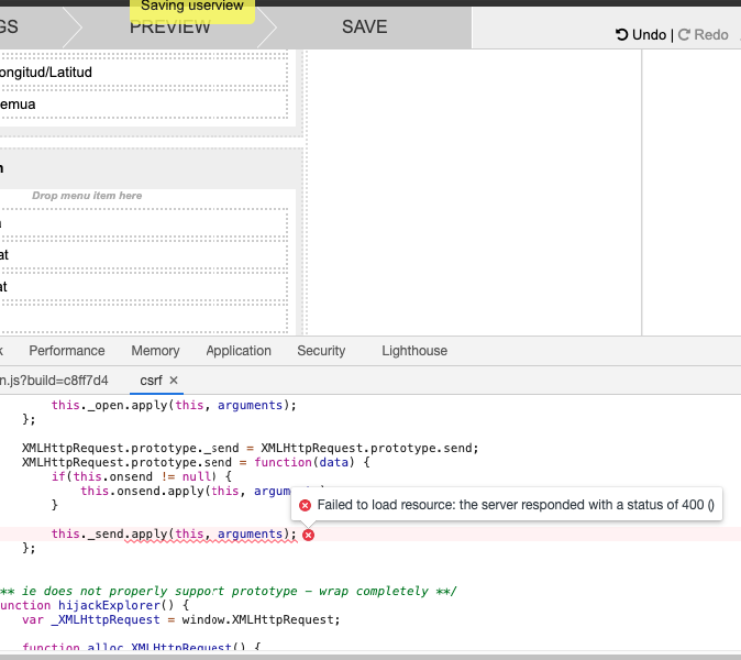

Any steps to replicate? Any error in browser console when you hit the error?

I've developed userview which contains more than 40 menus (jasper report jrxml (hide mode) and parameter forms with redirection). Now i cant add more jrxml to the userview. Try to edit directly on json but it wont save. Have anybody experienced this ? There is no error on joget, also no error on backend (mysql log). Upon checking json datatype on app_userview, it is already longtext data type. (v6)
