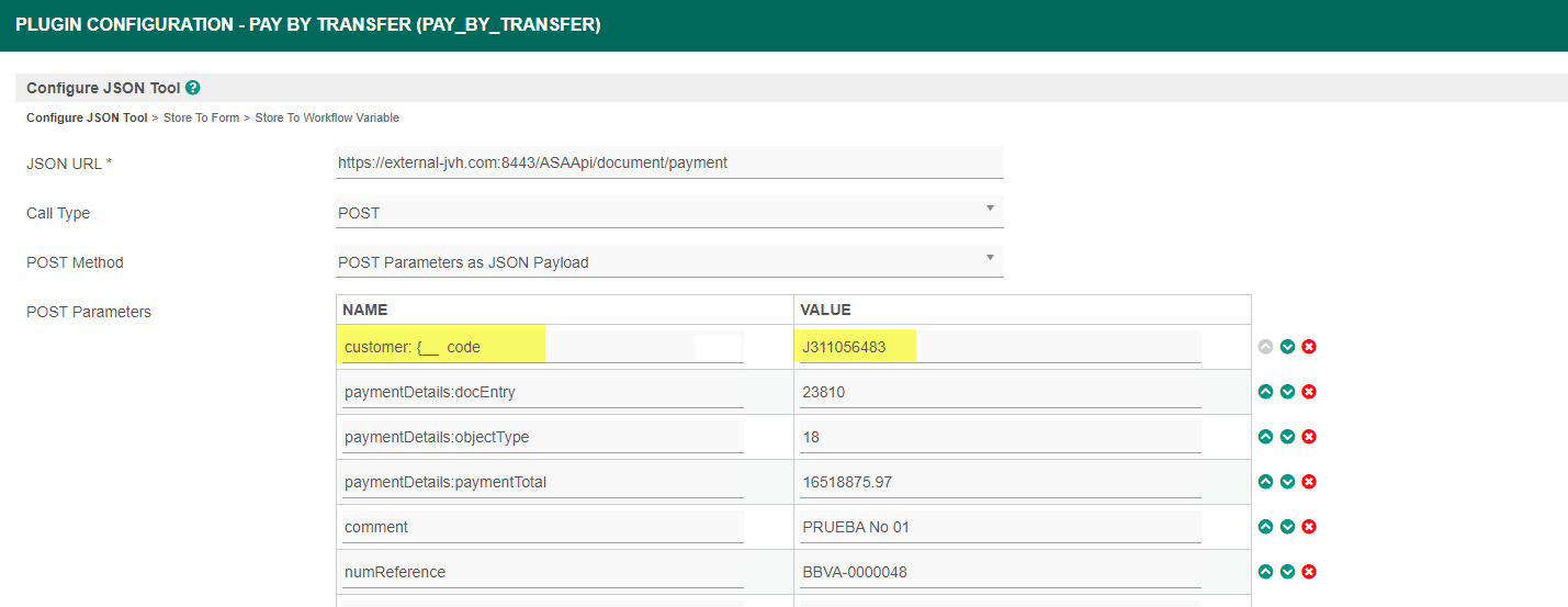

But really I need to use  POST Parameters as JSON Payload and need an example for the first, second, and third options that I show in this pic.

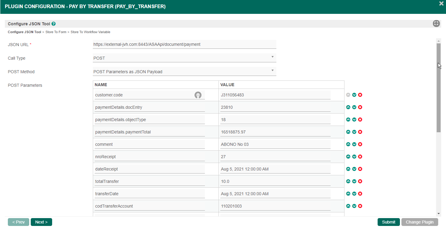

Whit this example I get this result and of course the Post Do Not work as I need
"customer.code": "J311056483",_ "dateReceipt": "Aug 5, 2021 12:00:00 AM",_ "docObjectCode": "46",_ "docType": "2",_ "nroReceipt": "27",_ "paymentDetails.docEntry": "23810",_ "paymentDetails.objectType": "18",_ "paymentDetails.paymentTotal": "16518875.97",_ "totalTransfer": "10.0",_ "transferDate": "Aug 5, 2021 12:00:00 AM",_ "transferNum": "125"_}
