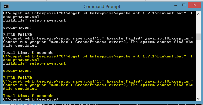

i have a problem again when executed the command why i still found "BUILD FAILED" error..
i'm already change "mvn" to "mvn.bat" in setup-maven.xml like this screenshoot, but it's still FAILED.
Do i missed something again in this command?

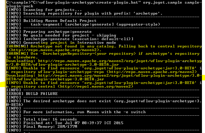

Hi Mat, i solved my Maven problem. So, i start "Create Userview Theme"
but i got new problem again like this capture above. Can you tell me what should i do?
Thanks before - Nana
I just follow this instruction http://maven.apache.org/archetype/maven-archetype-plugin/advanced-usage.html and its work. SOLVE :)
