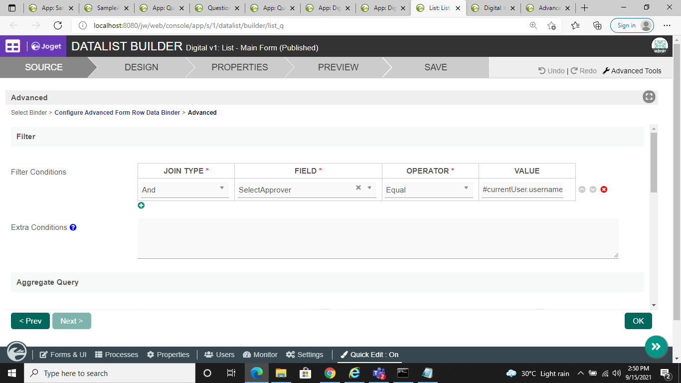

the user must see only his data, but admin must see all the data
above image is working for { visibility: if selectApprover== logged-in user}
but I want admin can see all the data of users, but user can see only his data.
please help me.
      duplicate the list and remove filter from duplicated list. Go to userview create new category and add permission 'Is Admin' and call the duplicated list which as no filter.
        A possible solution would be to duplicate the list and remove the filter condition.
        Then go to the user view and add the duplicated list in a separate category and put its permission to 'Is Admin'
        1. Sanjana KL
          Thank-you Anas
          it absolutely working fine!!
