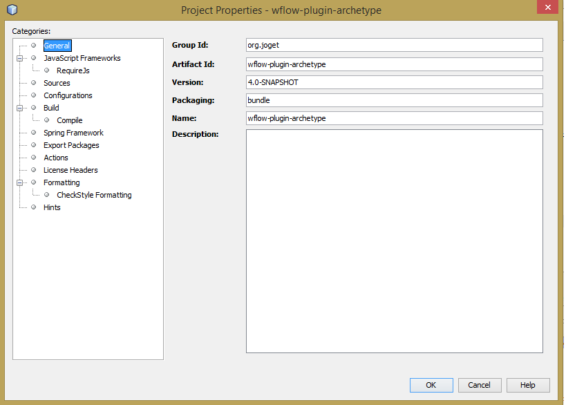

i've this error when build the project to custom userview themes
Bundle org.joget:wflow-plugin-archetype:bundle:4.0-SNAPSHOT : Bundle-Activator not found on the bundle class path nor in imports: org.joget.Activator

I really don't know what should i do..
Thanks before.
      The error "not found on the bundle class path nor in imports: org.joget.Activator" probably means the class is not found, so you need to ensure that the class exists in your project?
