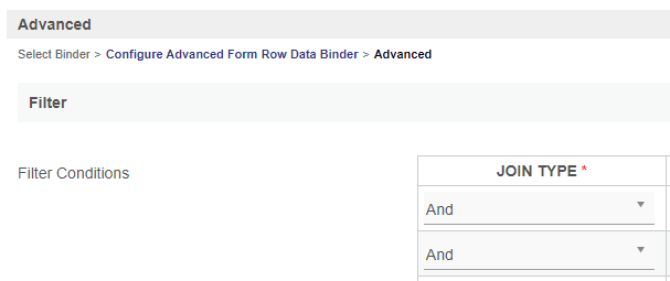

Advanced Form Row Data Binder - Combination of AND / OR conditions
How do I configure the Advanced Form Row Data Binder to achieve this type of condition
conditionA AND (conditionB OR conditionC)
When I add OR, looks to me that it is doing
(conditionA AND conditionB) OR conditionC
      Scroll down to write AND/OR conditions manually for complex use cases.
      example
      (status = 'Approved' AND country = 'US') OR (status = 'Pending' AND country = 'India')
