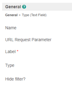

      Thank you for your quick response Anas. I just found another simple way to do it.
      1. In the datalist create the filter I need.
      2. Use the autogenerated "URL Request Parameter" to filter the datalist from my first datalist row action
      This is not obvious in Joget documentation
        You can pass the parameter in the hyperlink with list with lets say name "id" and then use #requestParam.id# in where clause of the query to access that parameter.
