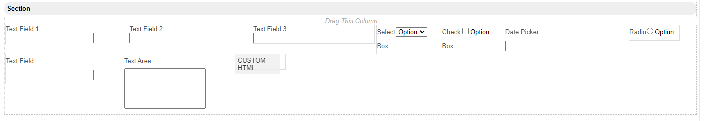

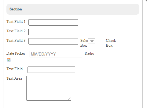

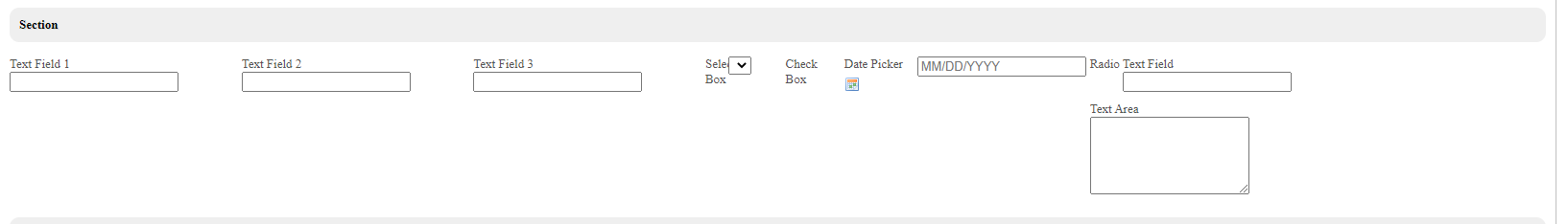

      I am having a hard time figuring out how you were able to do 2 columns in your example when in desktop view.
      When I follow your example I am getting all my fields on the same line and wrapping at end of line.
      And in the preview I am getting
      Desktop
      Mobile
      I still need the fields to be well laid out (in columnar mode) when in desktop view but collapsed properly when in mobile mode. Ideally looks like I need a combination of columns and row layouts.

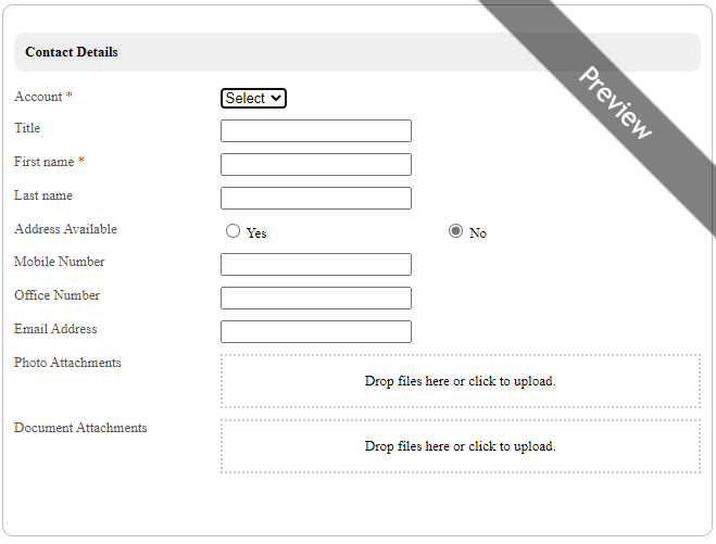

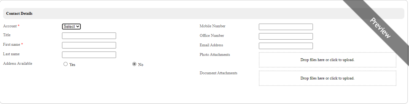

    You can see this behaviour from the Joget's own CRM app. See couple of screenshots below. Normally rows would collapse. With Joget the columns are collapsing.
    Desktop View
    Mobile View
