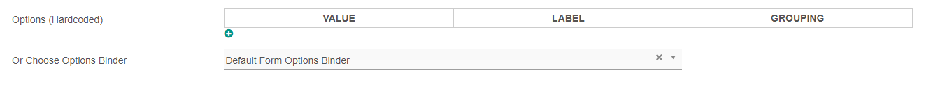

Your answer works but I think it is a bug in Joget because of the inconsistency in behaviour.
When a I use a radio button there is a focus border on the first element, and which disappears when I click on the radio button. How do I prevent this border from showing up?
Happens when I use Default Form Options Binder. If I hardcode the options, the focus border does not show up.
