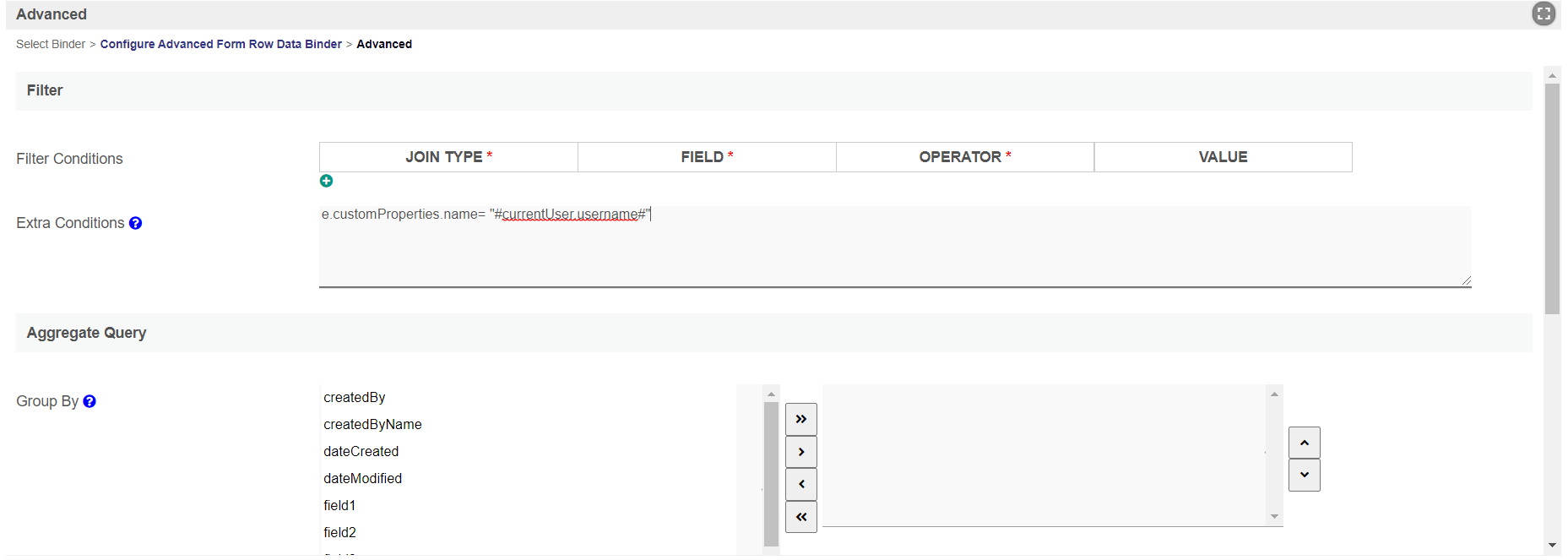

I've seen some people saying that we should apply a certain filter in the second category written like that : customProperties.name = "#currentUser.username#"? but i don't know where to write it

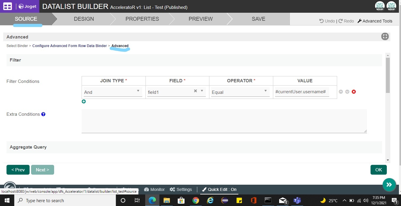

list→ source ->advance
this image might help u

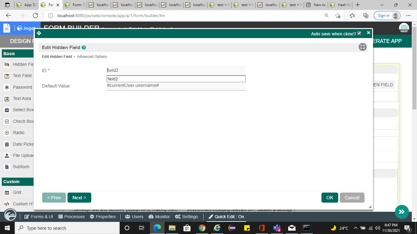

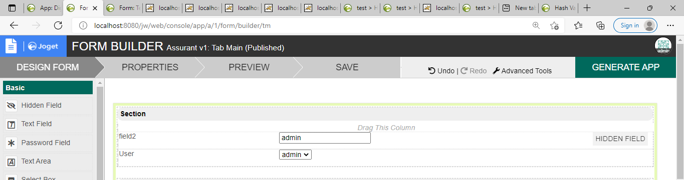

If client want to see his data :had filter, use hidden value and keep "#currentusername#" in default value
