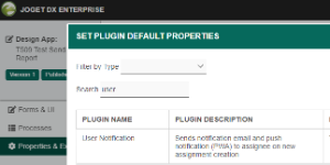

The user notification plug comes standard in Joget Dx, in App > Properties & Export > Set Plugin Default Properties > search for "user". See screenshot below:
- Danial Jefri
ohhh ok got it. Thank you very much

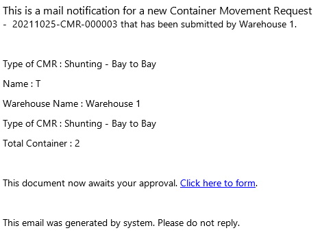

Is it possible to a link within email like the image below. When the user/approver clicks on the link, it will redirect the user to the specific page, for example an approval page.
Thank you in advance.
