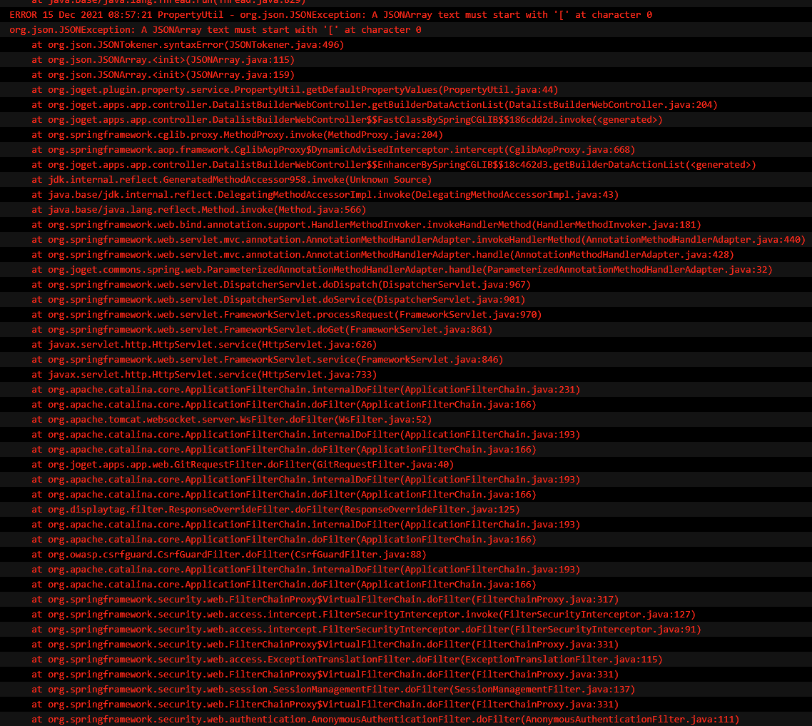

You may have configured a filter or a column in a wrong way. Please check that. Or
Go to advance tool > json definition. Copy the code somewhere. You will most probably find an error there
- Jun Feng Lim
I had finally discovered the cause of the error.
It is cause by the incorrect of syntax in JSON file in imported plugin.
Thanks for pointing out the direction of looking for the error.
- Anas Misbah Shami
Glad to be of help
I had noticed on error where happen in every datalist. So, the error only shows when the datalist edit page is load. Any idea on what cause this error message?
P.s. Error doesn't show when I edit and saved datalist. And the error also didn't popup when User view the list from live.
