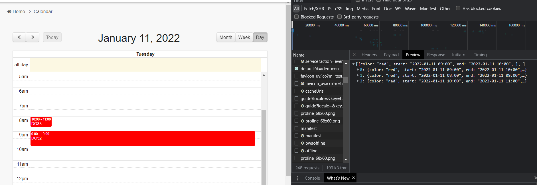

Daily Calendar showing not displaying events correctly
I have 3 events. The JSON data is correct but the daily and weekly events are not displayed correctly
JSON Data
Event 1>> {color: "red", start: "2022-01-11 09:00", end: "2022-01-11 10:00",…}
Event 2>> {color: "red", start: "2022-01-11 08:00", end: "2022-01-11 09:00",…}
Event 3>> {color: "red", start: "2022-01-11 10:00", end: "2022-01-11 11:00",…}
Calendar display
Event 1: correct height and width. Event is showing 9am-10am
Event 2: incorrect height and width for the event from 8am to 9am
Event 3: not showing event from 10am to 11am
Daily - INCORRECT

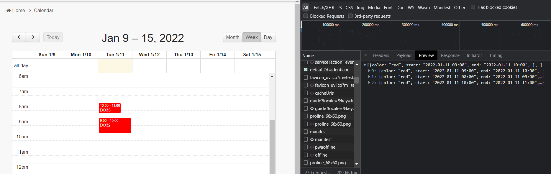

Weekly - INCORRECT

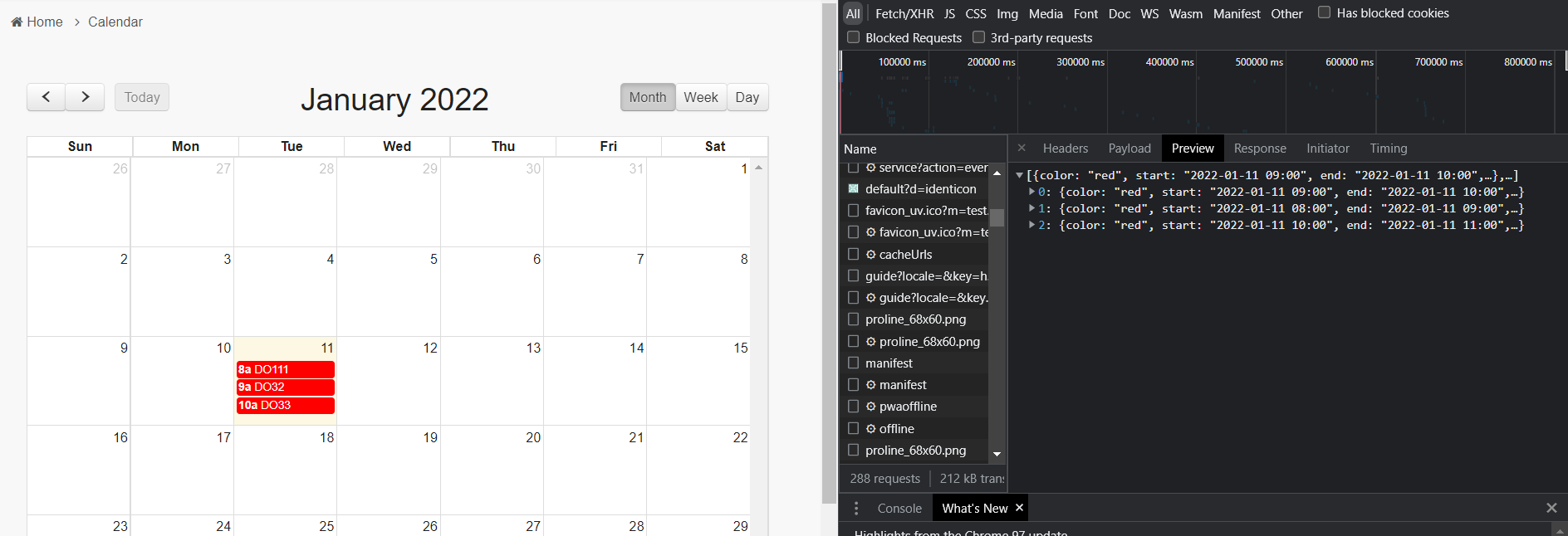

Monthly - CORRECT
      I created a whole new cloud account and the problem isn't appearing. I guess the other cloud account got corrupted.
        Can you please share sample app with data to replicate issue?
