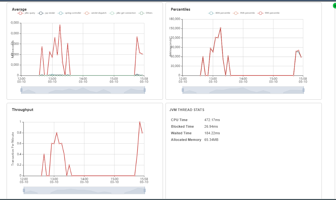

Hi, there is not enough information to help. Try to see what is actually performing the IO, perhaps you can make use of the Application Performance Management features.

here is the current of response time of one of the page. Please assist me on how to read this as I am not familiar with this. About 23 slow traces of today
