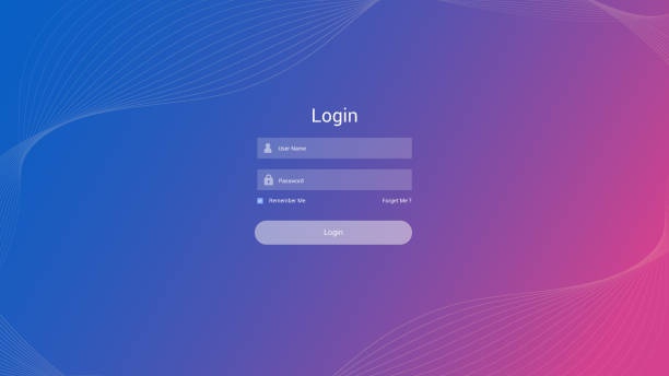

I want to create something like this ,and user after sign up or login will be redirected to the app without seeing the app center
      You can use the app's userview builder to change the UI via the Configure Layout > Login UI Page > Custom HTML (Before Login Form) and Custom HTML (After Login Form) properties, see Userview Properties
