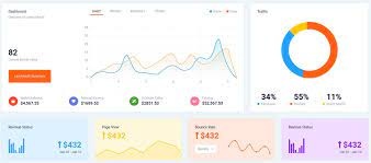

hello I want to create my own dashboard
I want to create a dashboard like this , what are the plugins and the tools that may help me or is it impossible ?
thank you

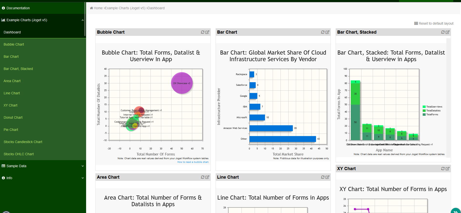

        These are for v5 Joget, but still work on DX (v7):
        https://marketplace.joget.org/jw/web/userview/mp/mpp/_/vad?id=APP_jtc-v1

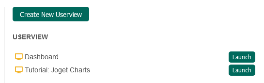

        What I JUST Learned:
        1) Create a userview – JUST for the Charts:

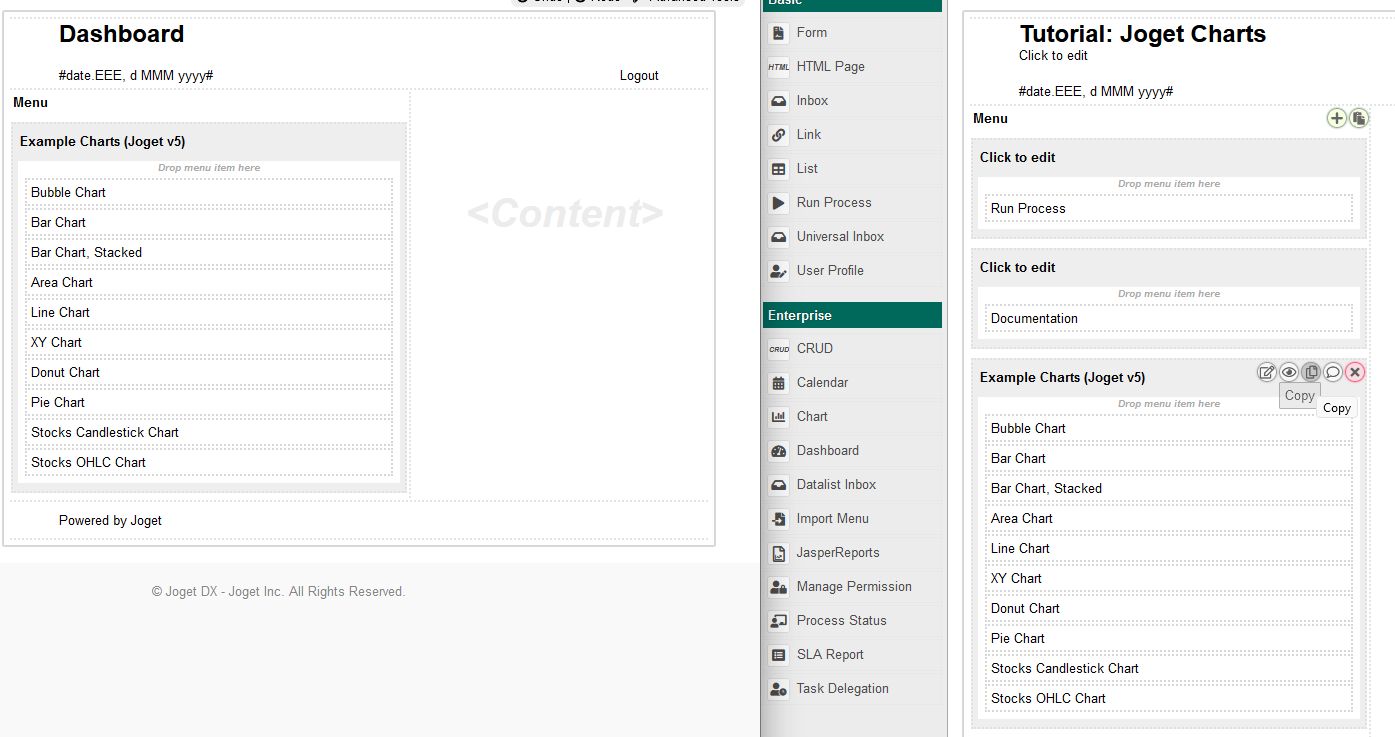

        2) Move all the charts into that Userview (e.g., you can copy and paste the Tutorial's Example Charts section – from the right, to the left)

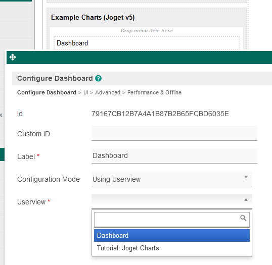

        3) Then when you add the dashboard, you point to the Userview of the "Dashboard only":
        4) Then when you load the Dashboard, it should load in all your Charts:
