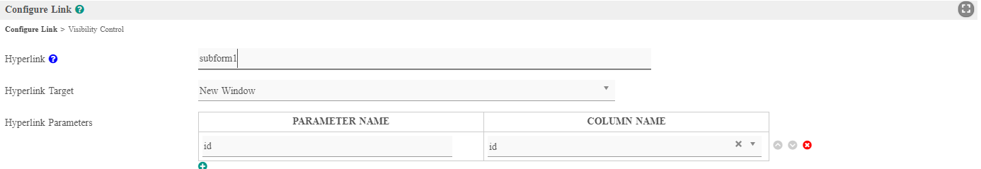

Hi, I believe it should be the column name HyperlinkValue as described in the Hyperlink Parameters header. Did you try that and does it work, or are you getting some error?
- Issa
I tried the code below and put HyperlinkValue in the hyperlink textbox but when the user clicks on it it will redirect to /HyperlinkValue not one of the options in the query (subform1,subform2)
ex:
If I have a query
select id,'subform1' as HyperlinkValue from app_fd_table1union
select id,'subform2' as HyperlinkValue from app_fd_table2
So if I have 3 form options I must create 3 action column and use the visibility option but it will stay appear as 3 columns

In the datalist hyperlink action, can we put the value of the hyperlink parameter as the value of the query result column
ex:
If I have a query
union
Can we put the value of the HyperLinkValue column in the Hyperlink parameter or it should be static?
