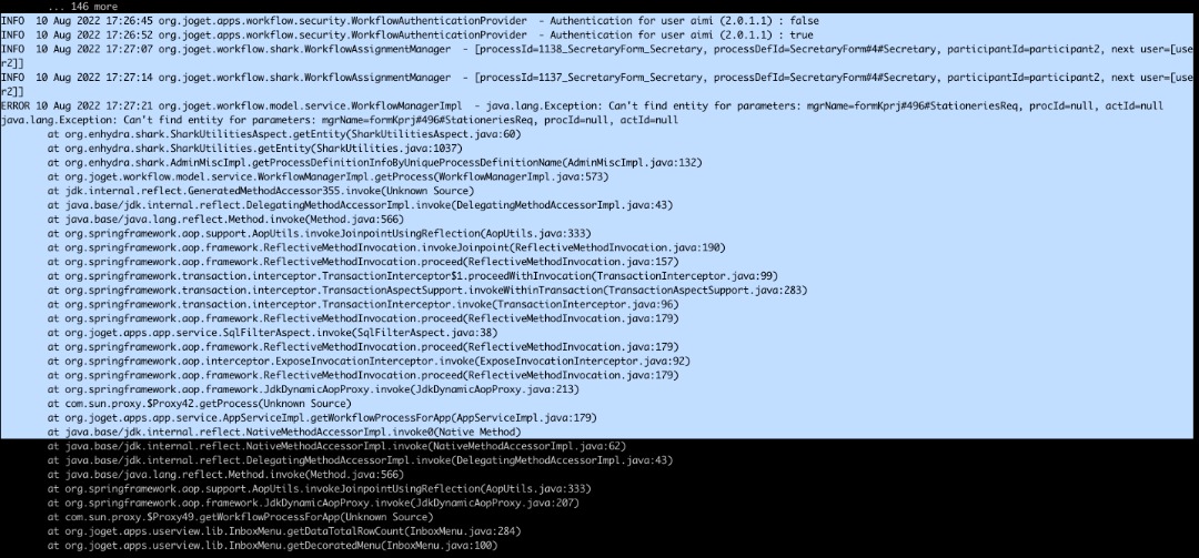

Error When deploy the process
Hi, im have problem when to deploy the process. Can't find entity for parameter. Its happen when i'm configure the email notification. Anyone know how to solved this issue?
      The error above could mean that Joget could not find the process definitions or mapping from the cache or the database. Maybe you can restore (re-import) the app from your backups.
