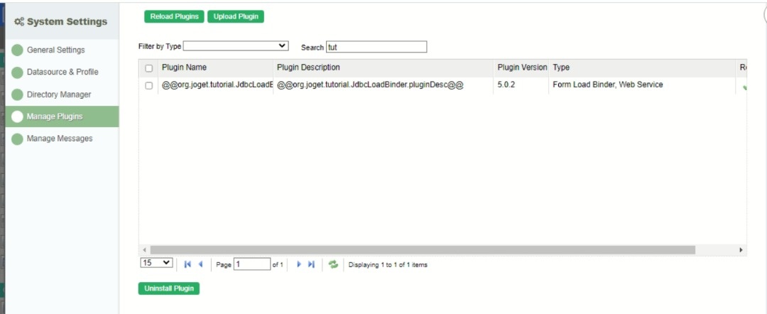

It is in v6 by default, you don't need to install a separate plugin. See JDBC Form Binder

hi, salam and good day,
attached screen :
plugin name : org.joget.tutorial.JdbcLoadBinder (JdbcLoadBinder(MarketPlace))
suddenly plugin name change to \\@@.....@@, any clue what are causing this problem ? . can reinstall back the plugin ? . this plugin from jogetv5, still use the plugin after upgrade to jogetv6
