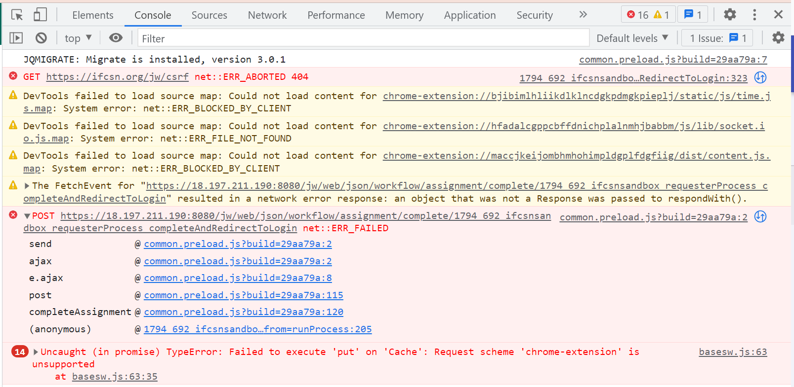

      any errors in the browser developer tool > console log?

        Also, in this case this Custom HTML is the only item in the page. It is a Form within a process.
