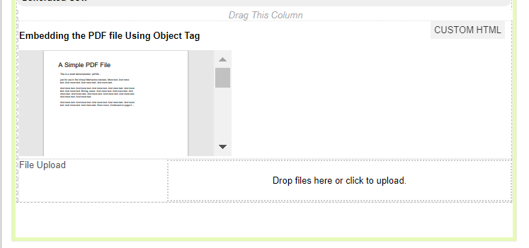

3. I tested base64 in Form Custom HTML its works fine, but custom HTML tag is not allowed under email tool attachments. Similar Custom HTML tried with Email body but if does not work.

5. in Below screen shot I tried to use Object tag (base64) but not accessible to email tool. Did not find any option yet to map PDF Stream to File Upload.
