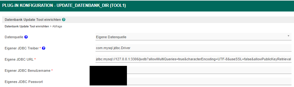

Thank you for your feedback. Your are right, it must be the multi statement. If I only store a query with hardcoded values, then the DB entry is made. As soon as I add a second query, there is still the same error, although I have adjusted the database connection as follows:
I have set the parameter allowMultiQueries=true in the first place, because this seems to be the way it has to be. Do you have any other ideas what could be the reason that the multyqueries are still not working?

If you are using MariaDB or MySQL, the multi statement in a single query option is turn off by default. You can enable this option by modifying your database connection string with "allowMultiQueries=true", read here.
