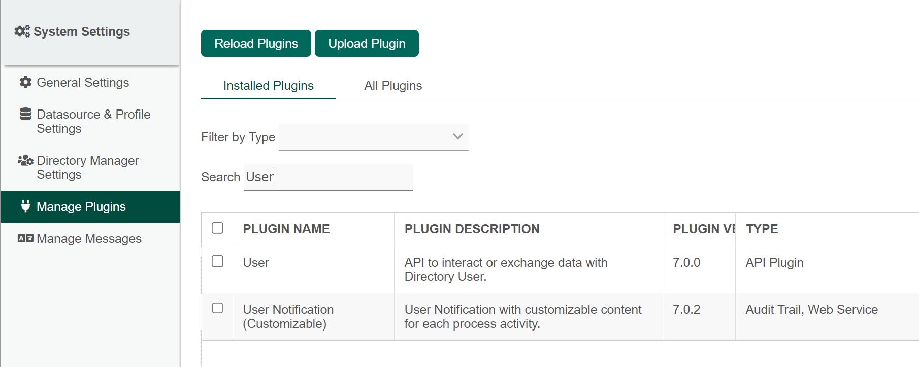

        Thanks, Anders. I have tried to go that route. I have installed that plugin (see here)

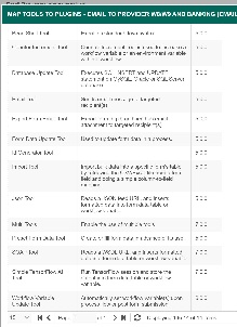

        However, when I tried to map that plugin to a tool I could not see it in the list (see here)

      2. William Vasu
        I see now that the settings are put into Plugin Defaults and not by adding this plugin into a tool and then it works for all assignments unless they are excluded. This seems to work for web pushes but not yet for emails. Will continue to test. Thanks!
