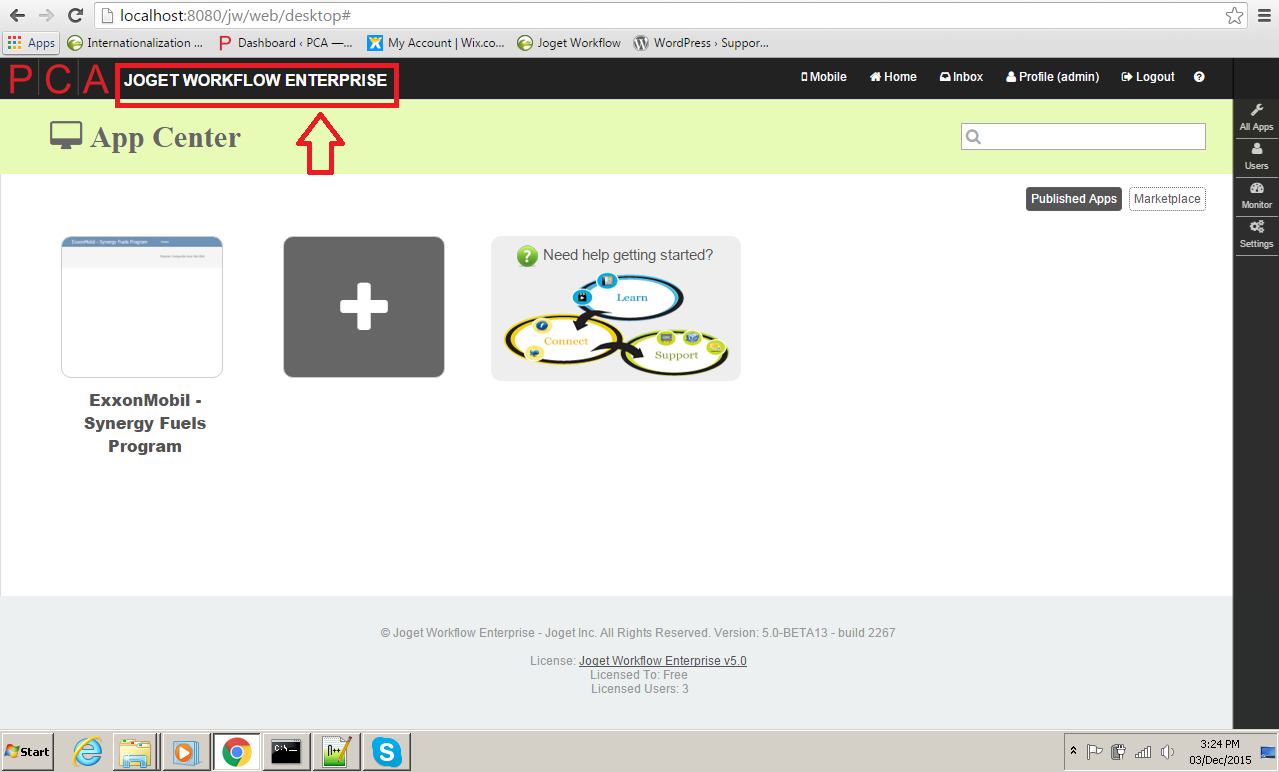

- Login to Joget as admin.
- Go to Settings > Manage Messages > Add Message.
- Set the key to "enterprise.console.header.top.title".
- Set the locale to "en_US".
- Type the new name you want.

Where can i find html source to change web title? Below is the screenshot.
Thanks you in advance.
