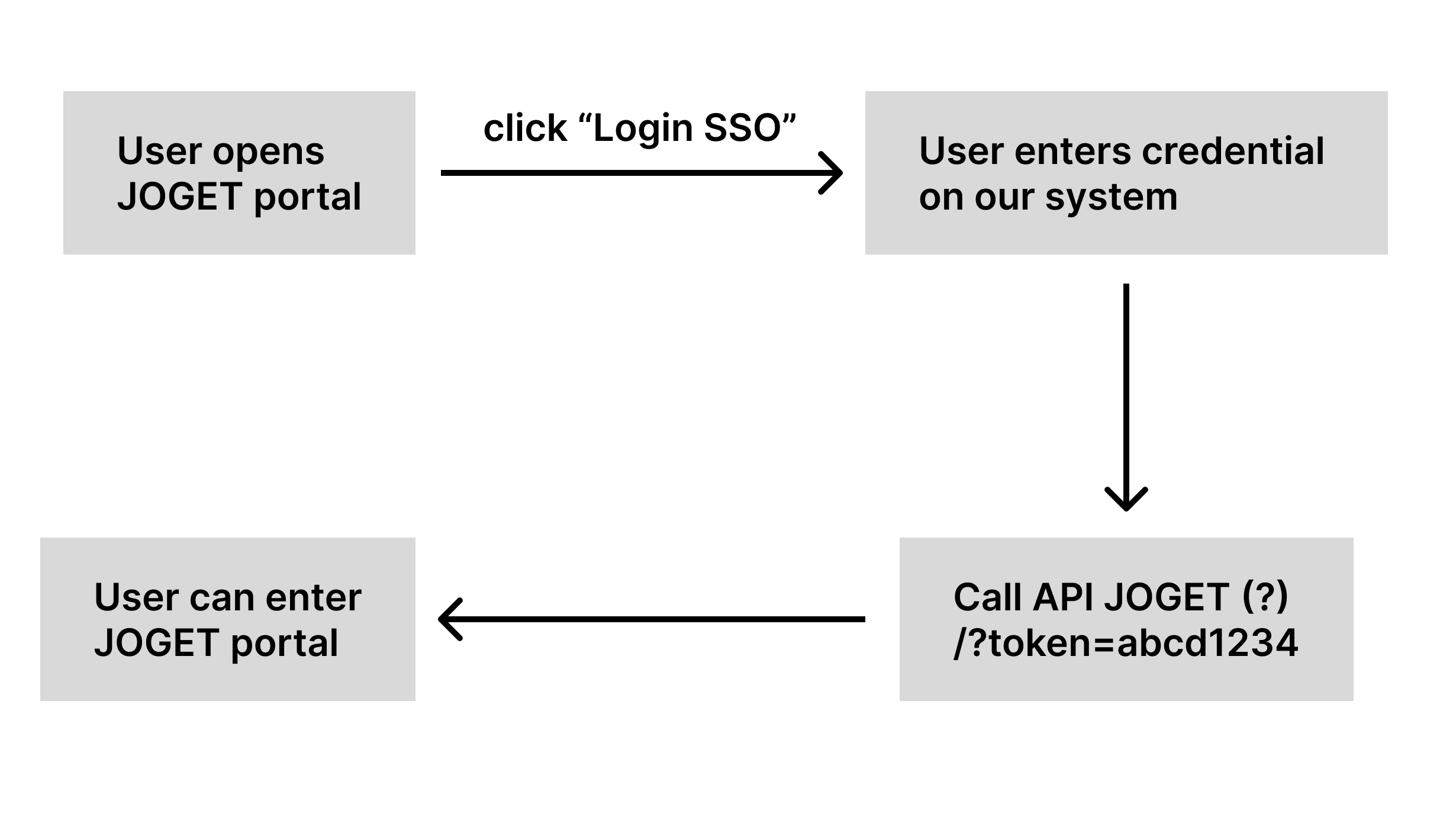

We are guessing that the mechanism is as follow. Can you check if it is correct?
What API can we call to pass token to Joget?
- Anders
Since it's your own token implementation, you should call your own plugin's web service to verify it before performing the programmatic login.
