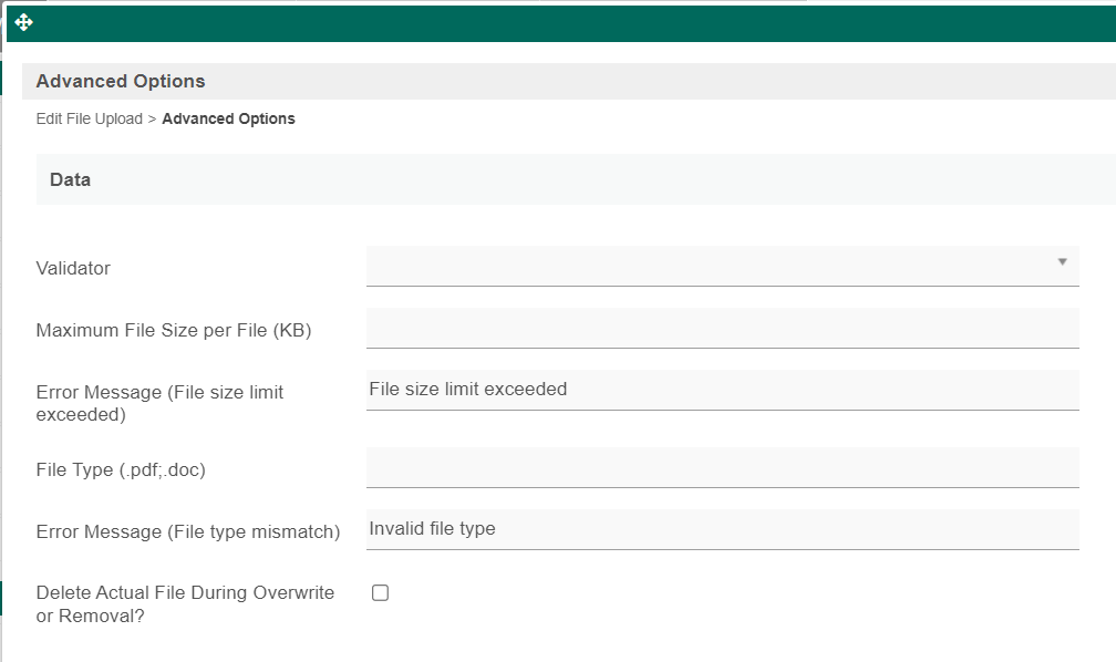

I still wonder if the file someone uploaded in form A in a previous workflow assignment is deleted or not if someone remove or replace it when they edit form A in a later workflow assignment. There's actually an option for user to choose whether to "Delete the Actual file..." so I'm assuming if the form designer does not explicitly choose to delete file, then the files are still somewhere in the database.

I have configured the field so that it will not delete the actual file during overwrite and removal
