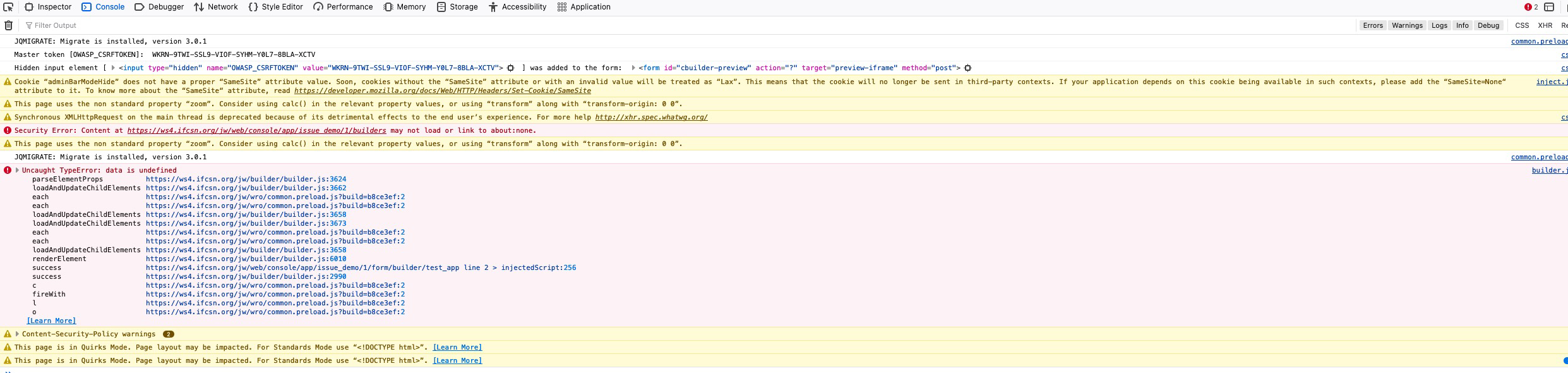

Thanks for the screenshot, any errors in the F12 browser dev tools or joget.log. To really debug, we need a sample app with just the affected form (you can delete the other UI and List to maintain confidentiality).
- William Vasu

Here is the Console:
