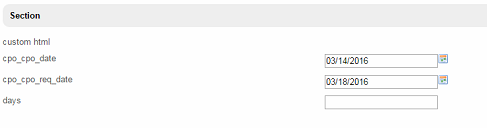

Hi Experts,
I want to calculate duration between two dates: cpo_cpo_date and cpo_cpo_req_date using custom HTML.
Unfortunately no luck when I try to preview, any idea?

      i tried ur code, look like u need to put it in as following. u attached the change event to an element tht haven't exist.
      <script>
      $(document).ready(function(){
          $('input[name="cpo_cpo_date"], input[name="cpo_cpo_req_date"]').change( function(){
                d1 = $('input[name="cpo_cpo_date"]').datepicker('getDate');
                d2 = $('input[name="cpo_cpo_req_date"]').datepicker('getDate');
                diff = 0;
                if (d1 && d2) {
                      diff = Math.floor((d2.getTime() - d1.getTime()) / 86400000); // ms per day
                $('input[name=days]').val(diff);
      </script>
