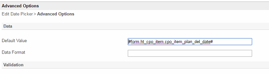

Two Date Picker fields:
  • Plan del date - cpo_item_plan_del_date eg. I will put in the form eg. 2016-03-01
  • Plan billing date - cpo_item_plan_billing - here I would like to have always + 10 days from cpo_item_plan_del_date I will get in the form eg. 2016-03-11
I was trying to use hash variable in Default value of cpo_item_plan_billing with reference to  #form.ht_cpo_item.cpo_item_plan_del_date# and somehow add 10 days but no luck.
I have checked hash variable #date.DAY+10.EEE, d MMM yyyy h:mm:ss a# it works but from current date.
Any thoughts?
BR,
Sylwester
