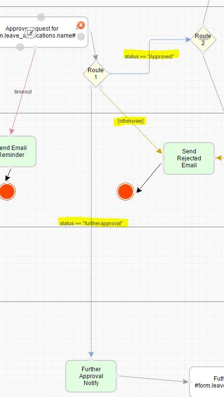

u can check the process status in Monitor Apps. see whether the workflow variable is set correctly and where the process stop if it does not go to further approval correctly.

Hi panda, Yes you are right. The workflow variable name was set to other variable. Now it is fixed. Thanks

Hello everyone,

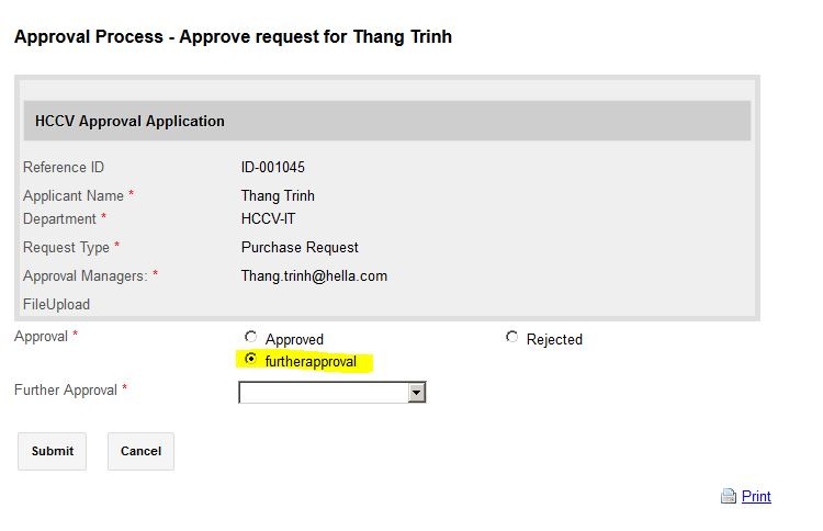

Could somebody support me with the Route1 here. I wonder why the route do not go to The further approval when user select furtherapproval button in the second picture?
