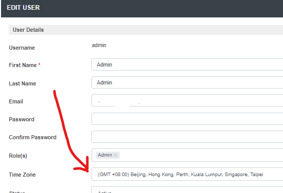

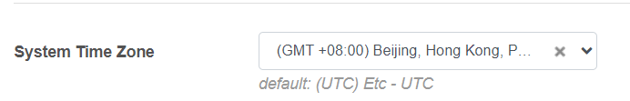

You may need to change the time zones in two places:
- The General Settings System Time Zone.
- The Setup User > Username > Timezone (see screenshot below). You can also make this change in the App Center > Profile > User Profile.
"Do I need to update all the users time zone manually..." actually if the Setup User time zone field is empty/blank, Joget will default to the System Settings time zone.

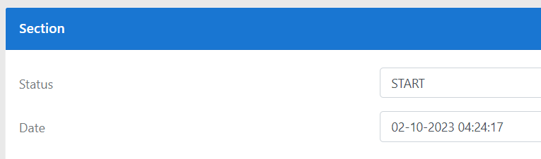

Hi Joget Team,
I am using Joget Cloud and noticed that the current datetime is not reflecting my time zone Kuala Lumpur datetime.
It should be 12:16:22 PM
I have updated the system time zone in the general settings but still no change:
When I am using date hash variable in the form also it is not reflecting the correct time:
