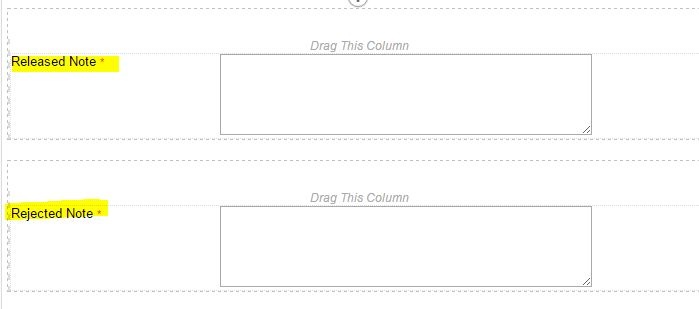

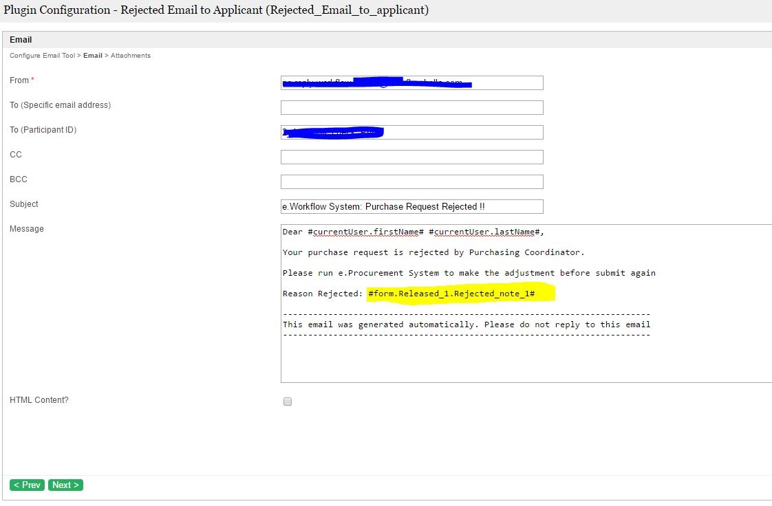

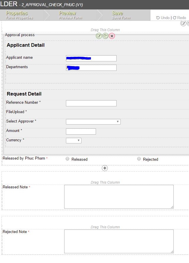

      I could not retrieve the output from the email.
      Here are steps I have done:
      1. Form designed
      2. Define fom field in Email:
      But the result is not show as expected.... Please advise.
      Thank you
        Hi Thang
        For example guide on your question above, do download and explore the free app for Service Help Desk which uses hash variables in email (Process>Map to Tools).
